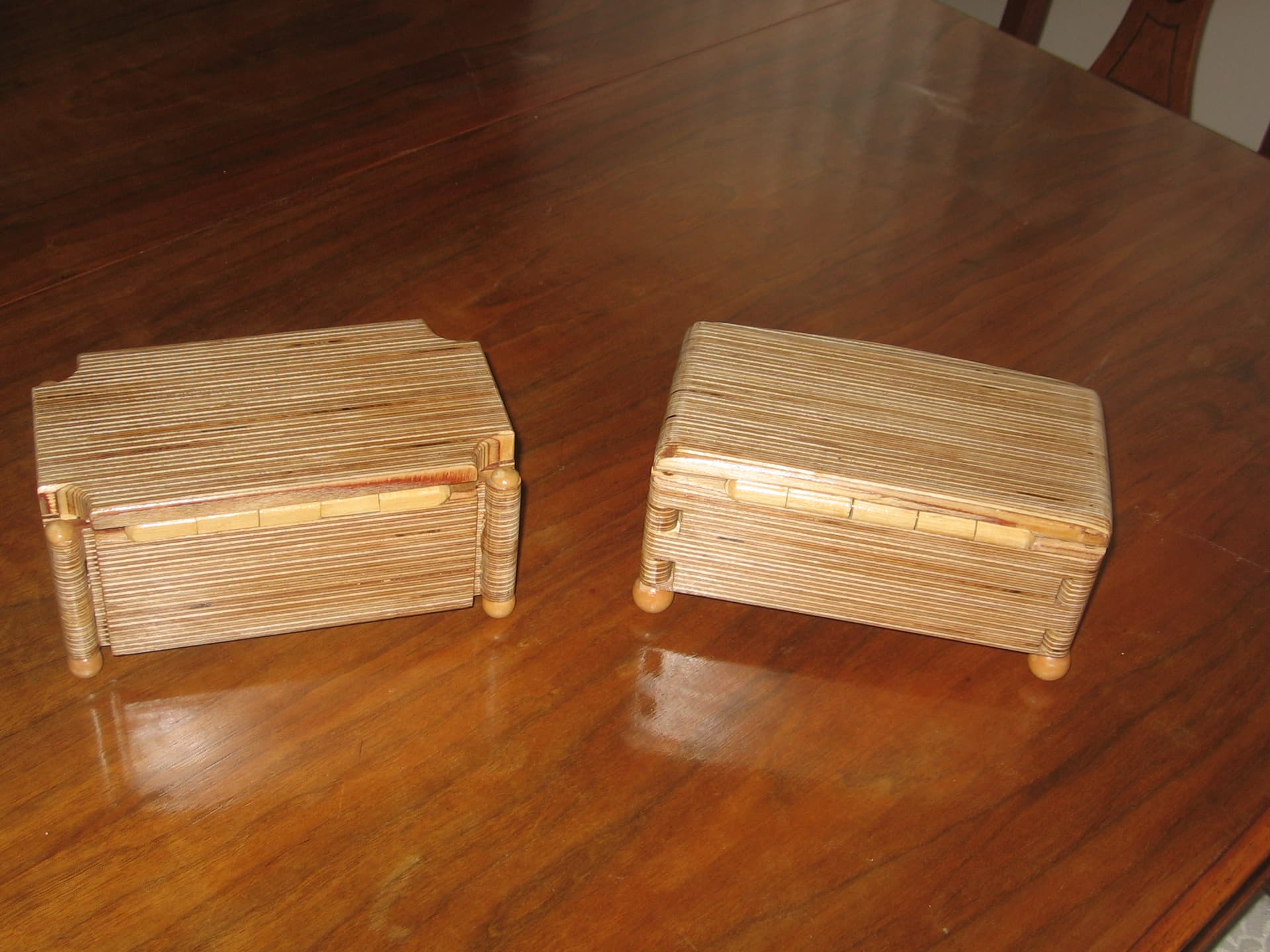

This involves making a “Log” out of a sheet of 3/4" Russian Birch Plywood. Russian Birch is similar to Baltic birch, but not as high of quality of the inner plys. It has more solid knots and bark on the inner layers.
I ripped it on the table saw into pieces approximately, 24"L X 12" wide and glued a stack of them up 12" hi. Then ripped them on the band saw into boards about 7/8" thick showing the edge grain across the board.
