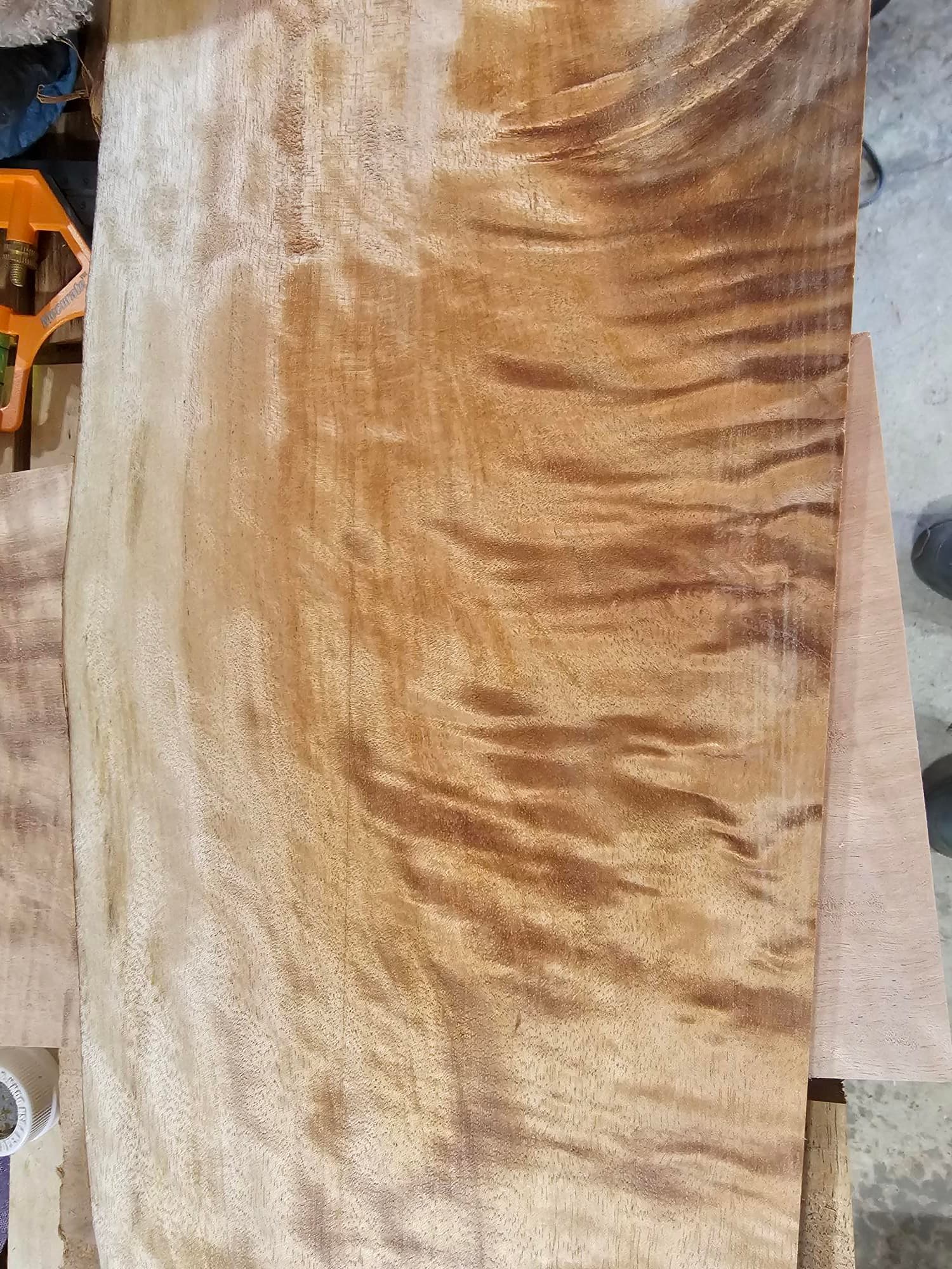

I found this piece of maple in amongst some pieces that I collected several years ago. Maple is not something I have any experience with. Is this grain pattern what is referred to as quilted? I was looking for a piece to make a cutting board, but I am not sure that is the best use for a grain like this. The pictures show the piece as sanded and then with some mineral oil to pop the grain. If i oil this piece it probably won’t have much luster, so the alternative is to make it some sort of serving piece and finish it with something with a glossy finish. Thoughts, advice and comments are most welcome
Bill
Hi Bill. That piece is most definitely quilted or “marbled” maple. Don’t waste it on a cutting board! You might want to use it for the top of a box or something else where you’re looking at a larger piece of wood to show off the complex grain pattern. If it is thick enough, you might even want to slice it for book-matched inlay.
Finish could be whatever product you like, but I would probably lean toward glossy to accentuate the grain.

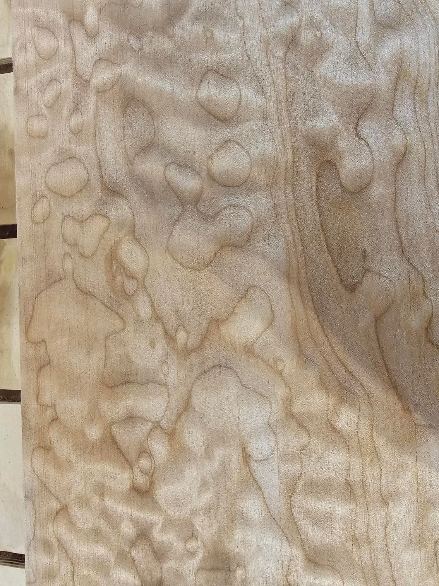

Thanks for the reply. I took your advice and set the piece aside for now. The board is just short of 2" thick, but the quilting only goes about 3/4 to 1" deep on one side.

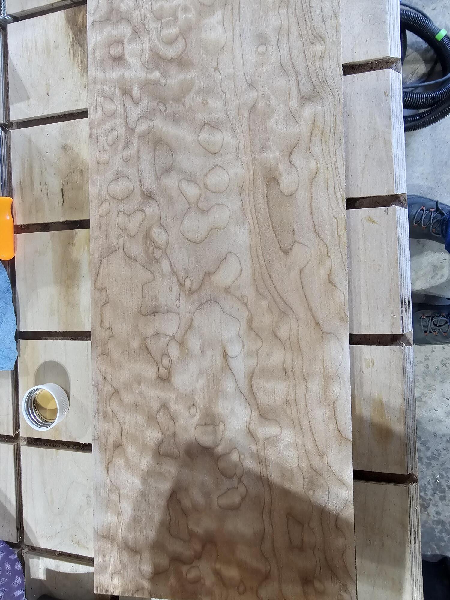

I grabbed another board from the pile and ran it across the jointer, this is what I got. The picture doesn’t show well, but there is a feather like detail on one end and kind of a rolling wave type grain across the face. The grain goes through the entire piece which is just short of 2" thick
Don’t necessarily judge how deep the quilting goes based on the end grain. You might be surprised that it goes deeper or there may even be a different grain pattern partway through. If you have 2 inches to work with, I would seriously consider splitting it on the bandsaw for possible book-matching. At worst case, that could give you some nice three-quarter inch thick pieces. You might be as nervous as a diamond cutter, but heck, this is a hobby, lol.
Bill, I see the second piece is showing some tear out. It’s a beautiful wood, but it requires, as you likely know, that the tools have really sharp edge…birdseye maple is somewhat in that domain. Best of luck.
Thanks for the reply. The tear out is mostly my impatience at work. The wood that I get is mostly saw mill rough and weathered on the faces so I plane or joint it to get a look at what I am dealing with. I can’t really see the grain before I take the first pass or two. If the piece is nice, I take a little more care after that.

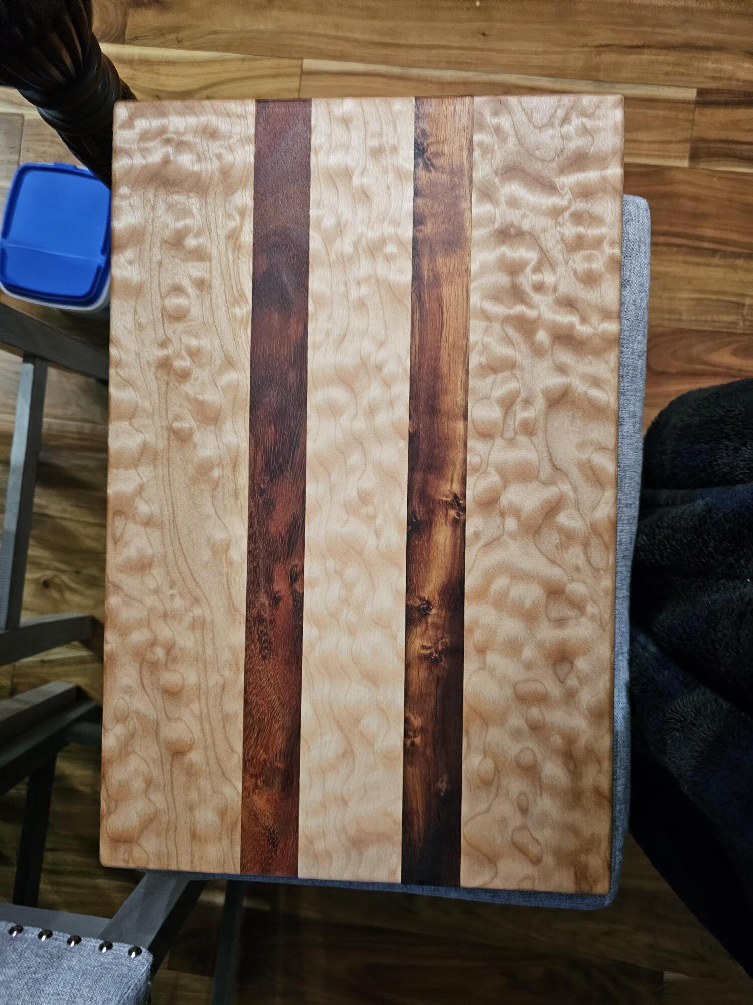

Since my access to more product has been cutoff I don’t have the surplus that I have enjoyed in the past. That being said you are welcome to come out and see if there is something that you can use. I charge $20 a bd/ft for the Koa, the maple is way cheaper. I do have some curly maple that I will part with, but I don’t sell the quilted stuff. I just can’t replace it anymore. Most all of it is something like 11 to 13% moisture content and has been air dried for a year or better. The Koa is roughly 6/4, the maple is roughly 10/4. I have been laminating the Koa edge grain with the maple face grain to get cutting boards that are 2” thick. I added a pic of one below. Let me know if you want to come out, I am home most days.
Bill
Hi Bill,
That’s a pretty cutting board, I’d feel bad cutting on it!
How does the quilting hold up to cutting?

The quilting hates almost any attempt to cut it. Micro tear out with any type of planer or jointer work and burning due to the sugar content with most saw cuts. I pretty much try to get it to about 1/32 from finish and then run it through the drum sander at 120 grit. It sands quite easily after that. I am quite curious about the myrtle, let me know how that goes.
