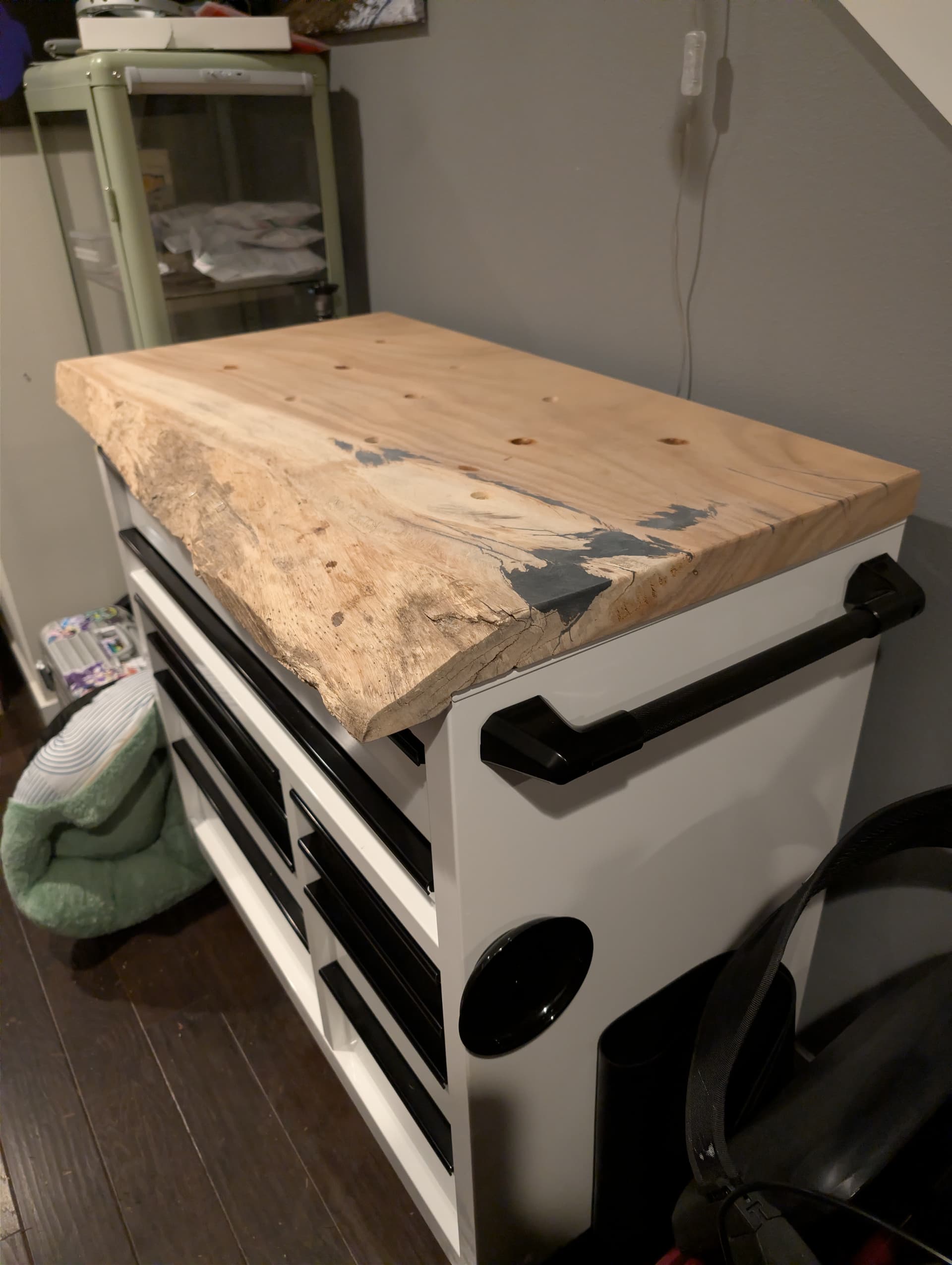

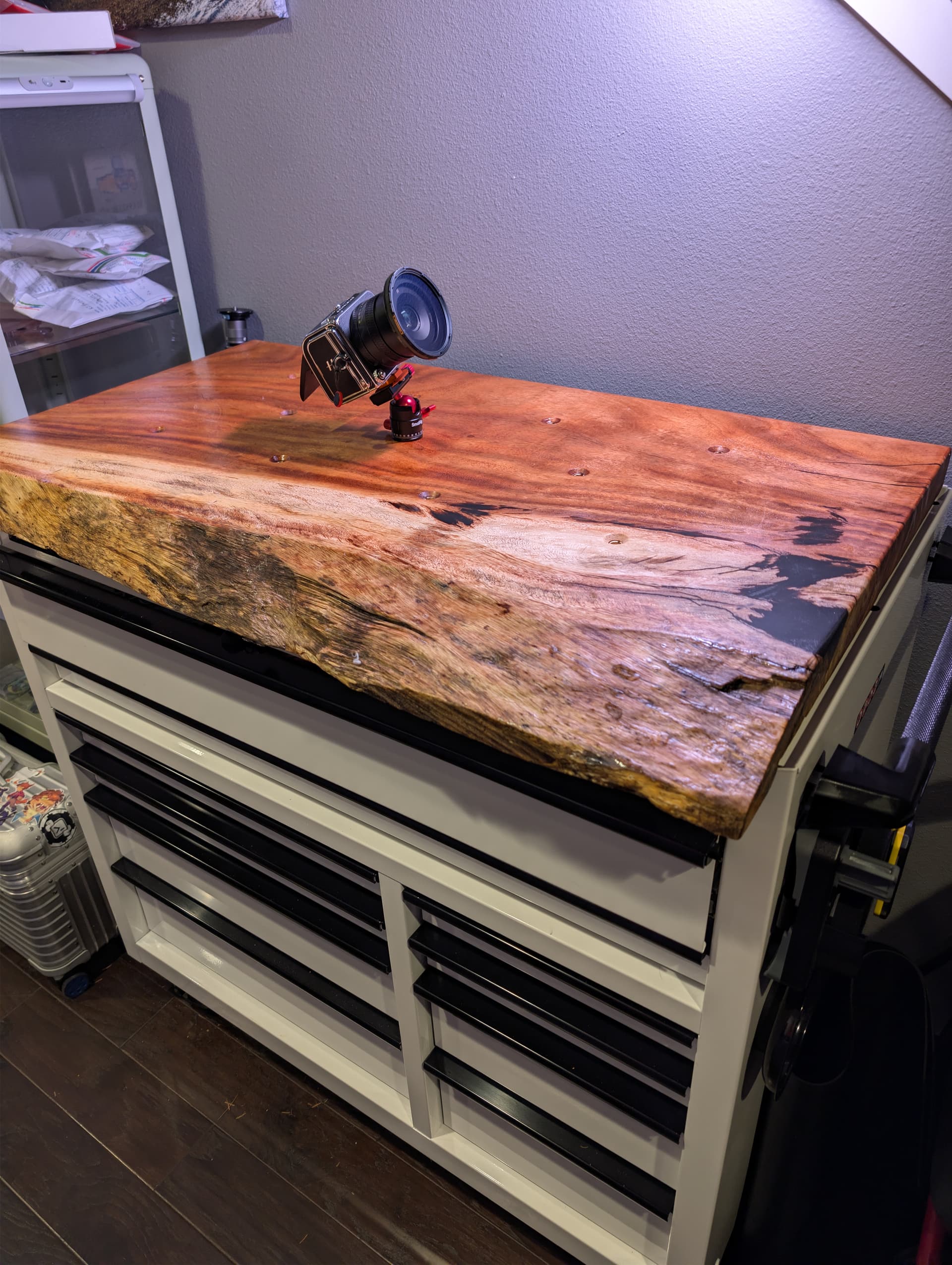

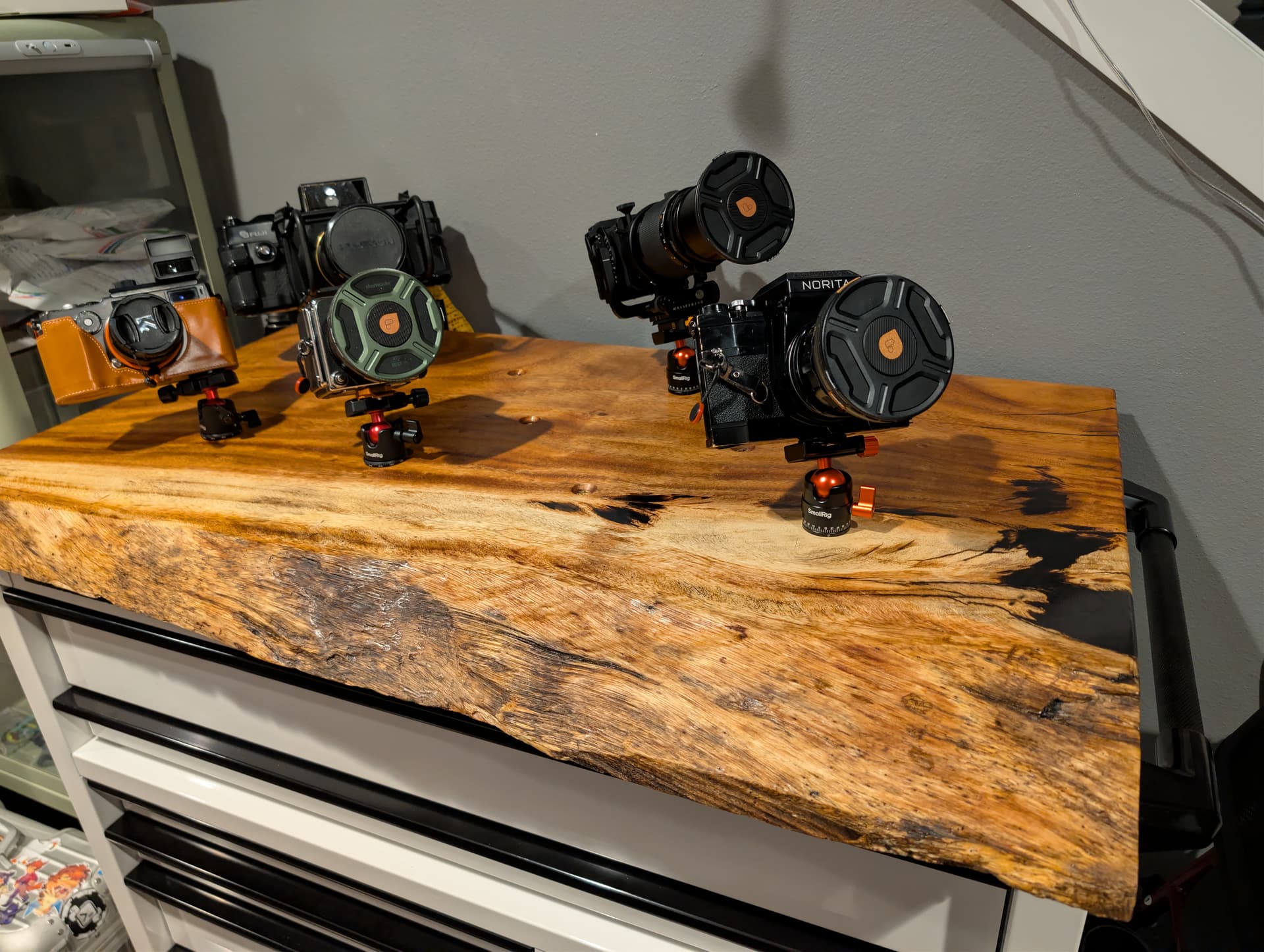

This is my Camera Shrine. It’s a display for my vintage cameras built on top of a tool chest that stores lenses, filters, tripod parts, etc.
Technically not finished, as I’m going to make floating shelves that match from the same slab, but I postponed that to work on some other stuff.

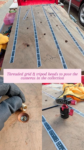

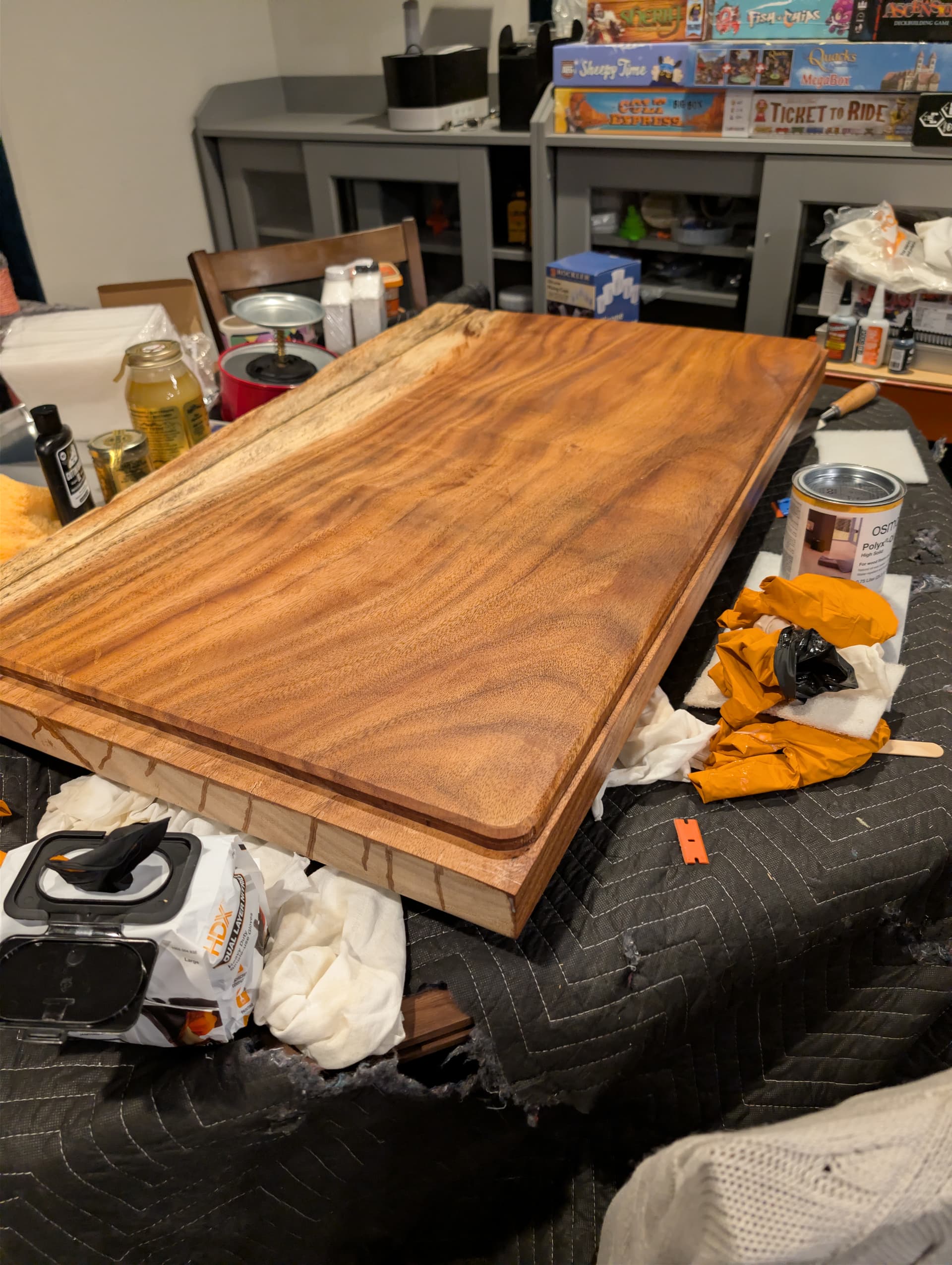

Monkeypod, grooved to fit the recessed lip of the chest, and a grid of threaded inserts to allow tripod heads to pose the cameras. This also allow them to be added or removed quickly when I decide to take one out with me.

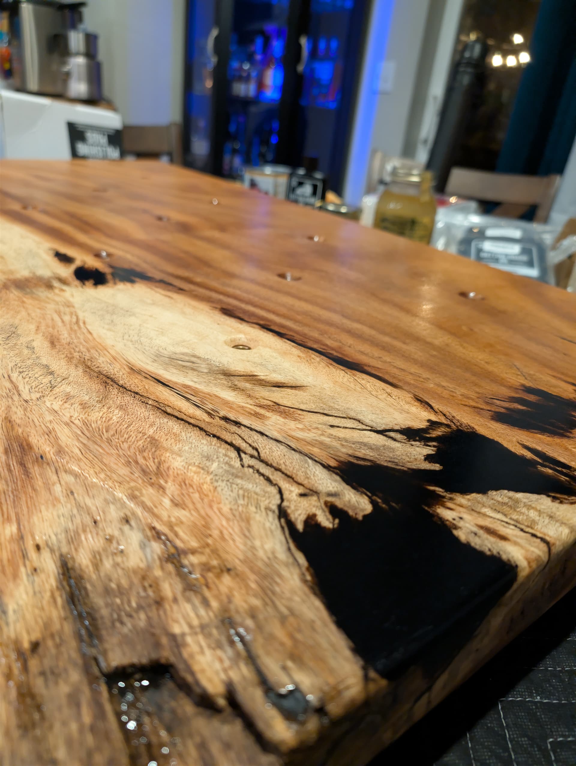

Finished using walrus furniture oil followed by the butter.

That’s stunning and you’ve got some nice cameras too! Welcome to the group!
Cool idea to put the threaded inserts for easy camera mounting. That slab really pops with the finish, too!
